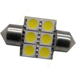

Stropne ?arnice: 3175 (cevne 30-31 mm "Festoon")
post-1144-1377668795_thumb.jpg ,

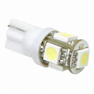

Za tablico: 194 W5W ("Wedge")
Orig. ?arnice so 5W (ledice bodo manj).
