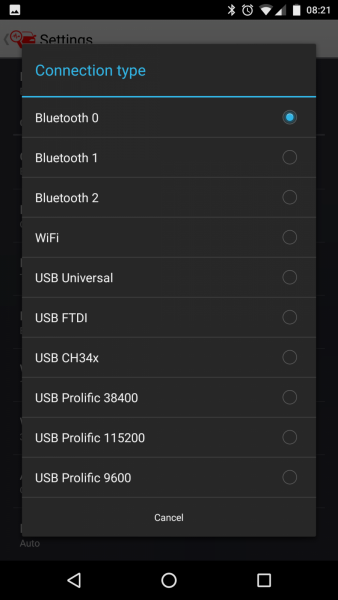

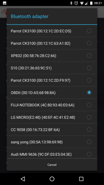

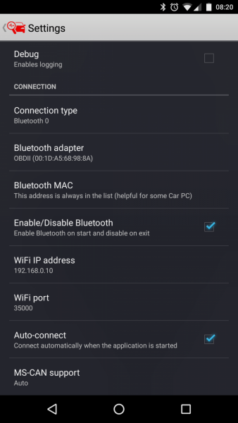

Ampak spet se mi Forscan apk ne pove?e z avtom
Log je bil pa taki
(WARN)  [21:19:48.169] Checking OBDII... (OK)
[21:19:56.449] Adapter:  ELM327 v2.1 (ERR)
[21:20:13.437] Unable to connect to vehicle. Please make sure the ignition key is ON and try again (OK)
[21:21:51.778] Disconnected(WARN)
[21:22:26.024] Checking OBDII...(OK)
[21:22:36.708] Adapter:  ELM327 v2.1 (ERR)
[21:22:54.084] Unable to connect to vehicle. Please make sure the ignition key is ON and try again (OK)
[21:23:03.771] Adapter:  ELM327 v2.1 (ERR)
[21:24:08.492] Unable to connect to vehicle. Please make sure the ignition key is ON and try again (OK)
[21:24:27.284] Adapter:  ELM327 v2.1 (ERR)
[21:25:17.681] Unable to connect to vehicle. Please make sure the ignition key is ON and try again (OK)
[21:25:46.084] Disconnected
pa ?e slike kako imam nastavljen Bluetooth na telefonu
post-24-0-75028700-1501572365_thumb.pngpost-24-0-45417400-1501572367_thumb.pngpost-24-0-67963600-1501572368_thumb.png
