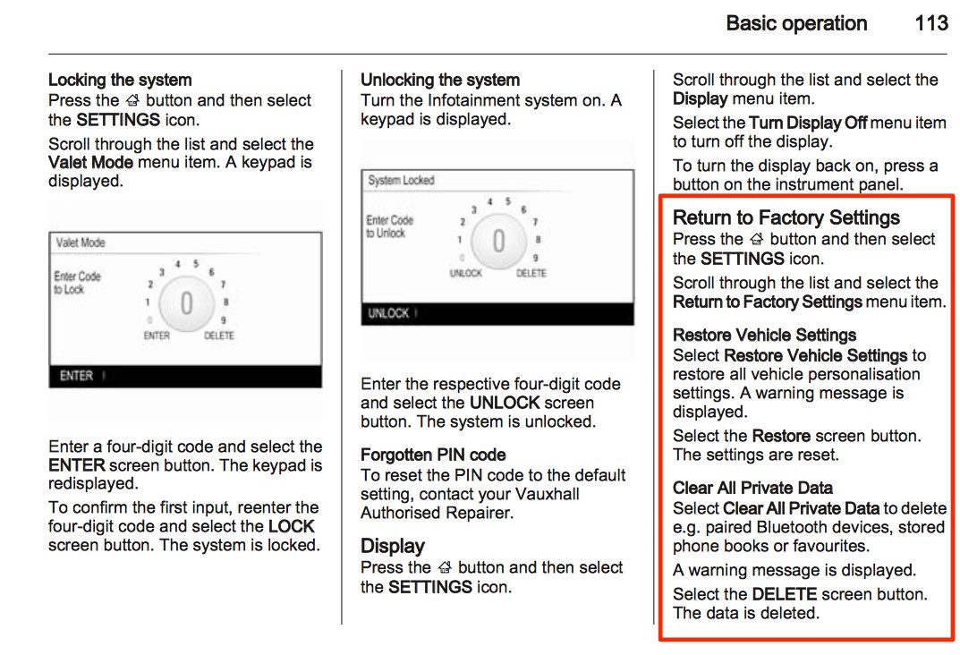

Reset na "factory settings" ne deluje? Sicer nisi napisal tocnega infotainmenta ... nasel sem recimo tole >> https://www.vauxhall.co.uk/content/dam/Vauxhall/Europe/united_kingdom/nscwebsite/uk/Home/pdf/infotainment/VX%20Insignia_Infotainment_Manual_Jan2014.pdf
2f6d41e529b91e249a2f9241f161615c.jpge30df06a828035ab7bcc6802f1811395.jpg59623852704124680b5ab933945ee857.jpg94c242b15a7c7c1247603f79a38a932e.jpg1af09245d9a7876276332d126fc0f019.jpg883a2f3f686913d3e60fa88f061dbaf0.jpg
Se 1x naredil vse kar si rekel ampak kot vedno ponastavi vse jezik italianski ko prizgem vozilo nazaj pa zopet vse njegove nastavitve radio bluetooth... se kak predlog
