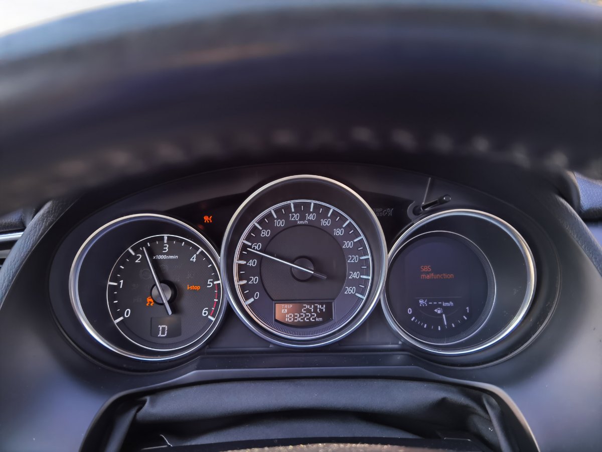

Na armaturi se je prižgalo opozorilo "SBS malfunction" , Mazda 6 GJ CD175, ročni menjalnik. Kaj bi to bilo?
Smart Brake Support.

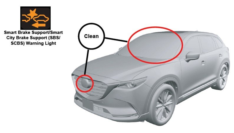

Probaj tole.
The SBS warning light may illuminate if the windshield and/or front grille emblem is/are dirty. Clean the windshield and front grille emblem. If the warning light remains on after cleaning, have the vehicle inspected at an authorized Mazda dealer.*  For more information, you may also refer to Section 7 of your Owner's Manual.
Kot je @Alexnapisal,očisti senzorje in bo ok. Tudi če je šipa pred senzorjem zamrznjena se pojavi to obvestilo,vsaj pri moji 3jki je tako,ampak po nekaj minutah ugasne.:prstgor:
pred 46 minutami je Janez007 napisal:
@Alex  in @Bini  hvala 👍👍.  Res je, po tem ko sem očistil značko in vetrobransko steklo, so lučke izginile :)
