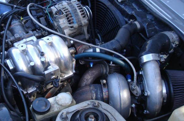

Here is one of the engines.. The engine in the avatar is my brothers. Its a 26b.We build rotary engines as a hobby as we have an engineering business.
