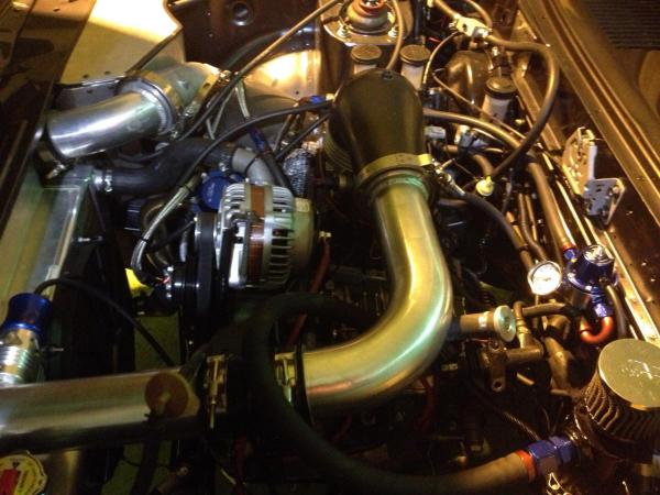

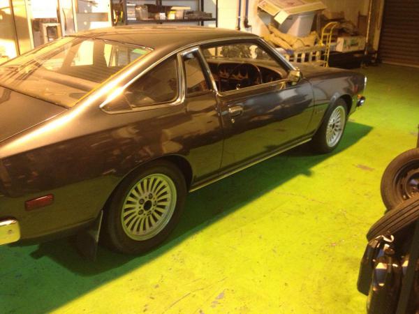

OMG  its a rocket :P:rispekt:
When are you coming to Slowenia? Which town will you live?
Amazing car, I hope to see it soon on the street.  :danzoman:
Going to live in ljutomer, car should arrive mid next year when we settle. But if anyone needs help with rotary stuff let me know as I can build them too...
Car will have australian registration for as long as I can. It's been engineered and meets all thier requirements. I think it will make it easier.

My car has pass engineering and standards here, I guess I would need to get homolocation there? With homologatiom do they take into consideration the age of the car (38 years old) with aspects to passing. I surely don't need to meet euro 5 standards for such an old car. Also my car is around 96 decibels. Is that ok there for oldtimer?

The easiest way would be to obtain a classic car certificate (from SVAMZ or SVS: http://www.zveza-svs.si/component/content/article/172.html), you should be exempt from paying any DMV import tax since the cars are oldtimers but not sure about VAT. Should also be a bit easier on homologation. If you manage to get an oldtimer certificate you also get a 90% discount on car insurance.
To get a certificate you make an appointment with SVAMZ or SVS and then someone comes and checks the car if it meets their standards. Might be a problem if you made a lot of modifications like turbo conversion, straight pipe, etc. You could make it original again for the inspection and then install everything back again as the certificate is valid for 5 years.
